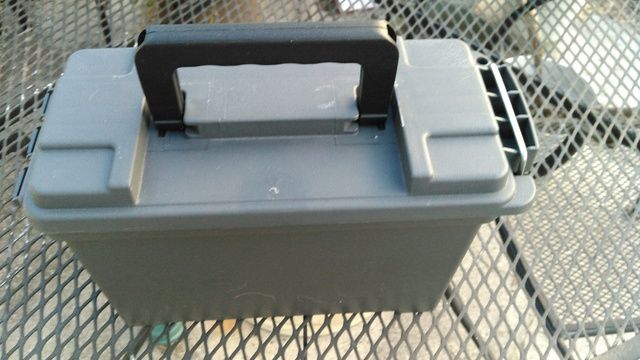

Today I was at Harbor Freight with some time to kill. That is when I spotted a nice little plastic ammo box that was on sale. It was small and it had a "corrosion resistant" bale and it was cheap! So I set about the store looking for the "must have" tools that would fit into the box. This is what I came up with... it's not everything but it is more than enough to let me MacGyver some repairs to get me home.

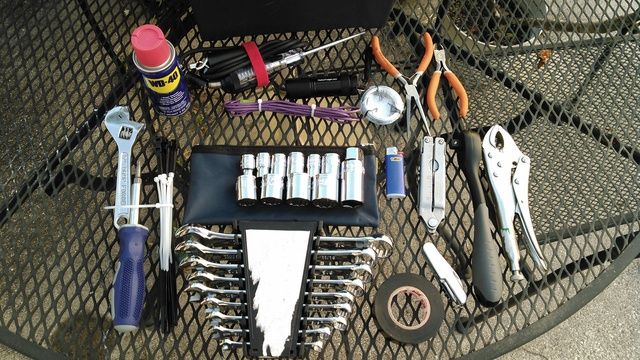

The contents I have come up with so far are:
  • Open end wrench set (SAE)
  • 3/8" sockets
  • Composite 3/8" ratchet wrench
  • Spark plug socket
  • 4-in-1 Screw driver (can be used as nut driver)
  • Adjustable wrench
  • Diagonal cutting pliers
  • Needle nose pliers
  • Locking pliers
  • Gerber Multi-pliers
  • "Swiss Army" knock off knife
  • Safety wire
  • Test light
  • Zip ties
  • Electrical tape
  • Small bundle of wire
  • LED Flashlight
  • WD-40
  • Lighter
Here it is all laid out:

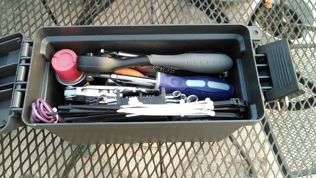

And look it all fits into the bos with room to spare!
