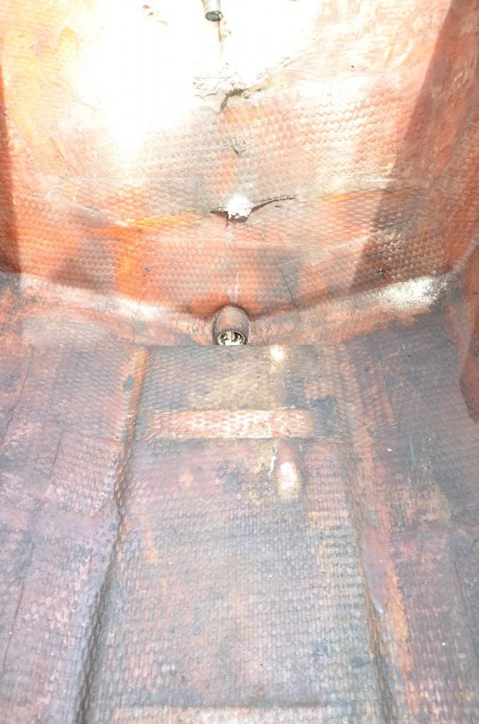

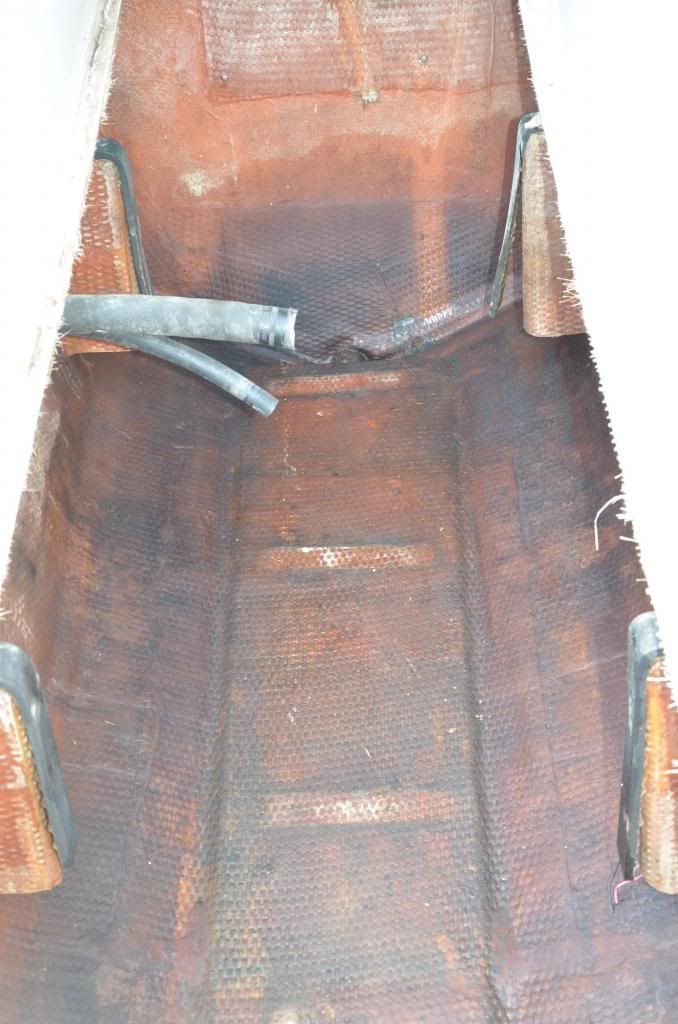

I got the old tank out today, and overall the bottom looks pretty good. Tank was obviously leaking, but I think most of it was coming out the top from the rotten seal on the fuel sender, which I'm guessing is also how so much water was getting in. There were some HUGE areas of pitting on the bottom of the tank, but no wet areas that I could see, no pin holes that I could find yet. Not sure how much time I want to spend looking though either. If there's any interest on this board, I'll clean it and wire brush it. Otherwise it's going to the scrap yard.
I took some pics. Let me know what ya'll think. I'm going to go pressure wash it. Pics are just after a quick vac.

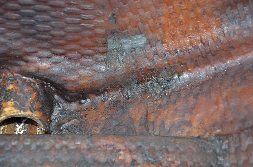

That Last picture raised an eyebrow. Large area, about 2 inch diameter with very lose fibers, and not much behind it upon first poke.

Post Posted: Sat Apr 19, 2014 5:12 pm
wow that coffin is really clean. tank doesnt look to terrible. if there isnt any pitting i would have it pressure tested. might save you a few on a new tank.
Post Posted: Sat Apr 19, 2014 5:41 pm
Agree with Corey, Ray. Clean it,pressure test to 3 PSI for 14 minutes, see how she does. BTW, the "chop" you showed in your last pick, that was probably stuck to a lam guys shoes when he was rolling out the cloth in the tank compartment...seriously! Nothing to worry about... :605_thumbs_up:

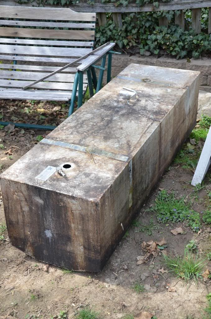

Already have the new 55 gallon tank sitting on the patio. On the very bottom of the tank where the neoprene straps were, there was some BAD corrosion. Easily half the thickness was gone in several spots. I really think that I got this tank out at the right time. If it's not leaking, it certainly would be soon. Under the tank was THICK with grease like stuff. Some of it didn't come off even with the pressure washer and soaking first for 20 minutes in Simple Green.
There was a few high spots of fiberglass that were riding hard on the tank that also showed some corrosion and heavy wear also. Id be shocked if I didn't find pin holes at a minimum.
