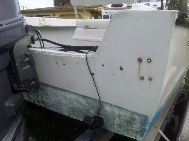

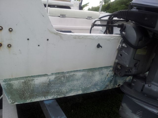

I picked up an original 1971 Flatback. It has the usual transom issues and a spongy deck just in front of the console. She looked good at first glance.
Posts: 1028
4,003,526.50 Points
Post Posted: Wed Apr 01, 2015 4:44 pm
Transom issues

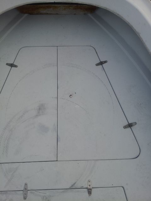

Deck
That is a fuel stain from leaking tank under console

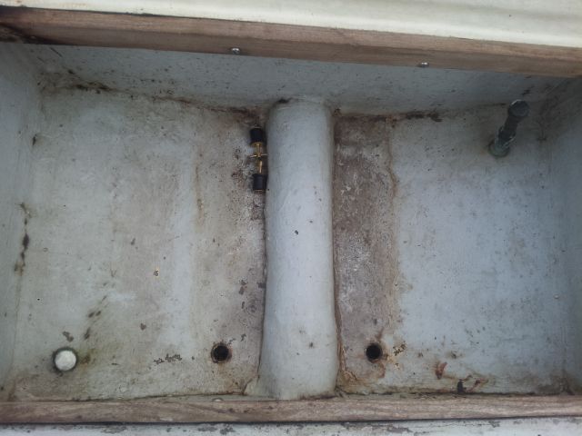

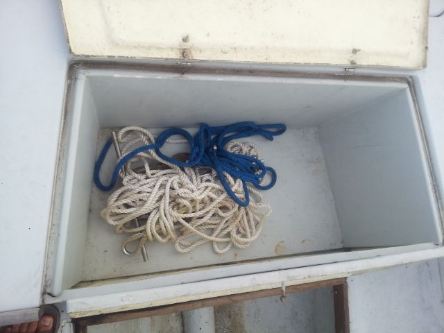

Below deck livewell
2 drain plugs and 2 fill stand pipes

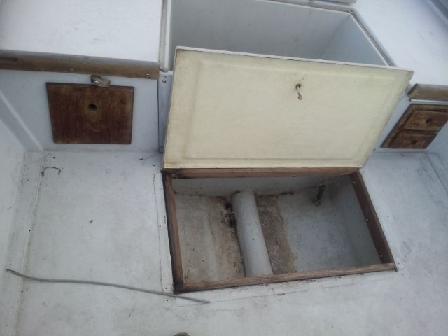

Casting deck
1 thing that should be noted was the 19-1 and the 22-2 shared a casting deck. On the Osprey and the 22-2 they put a panel up to fill in the area of the rear casting deck for storage. For the Gull the used a different console and removed the hatch and side plate for gas tank placement. Pretty cool idea. You can see it here in this photo

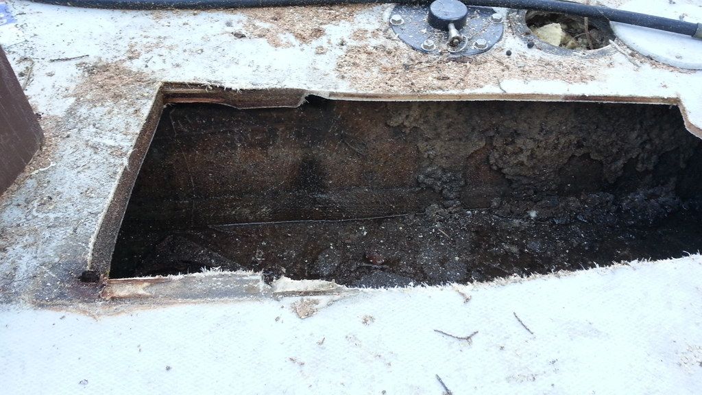

Well, I sold the big trailer that was under this boat. I knew she was a little heavy and water logged but boy I had no idea. I took her for a ride to see how she handled. At speed she slid a little, but when I hit a chop no movement and just cut it like a hot knife through butter.
Went to move her to a 3500lb trailer. Had her 1/2 way on and rear trailer support was on the ground and the springs were at full compression. sSc_eek and all her fat azz wasn't even on the trailer yet.sSa_cry4
So my plan to run her as she was is now foiled. Out comes the saws and grinders. :1898_:

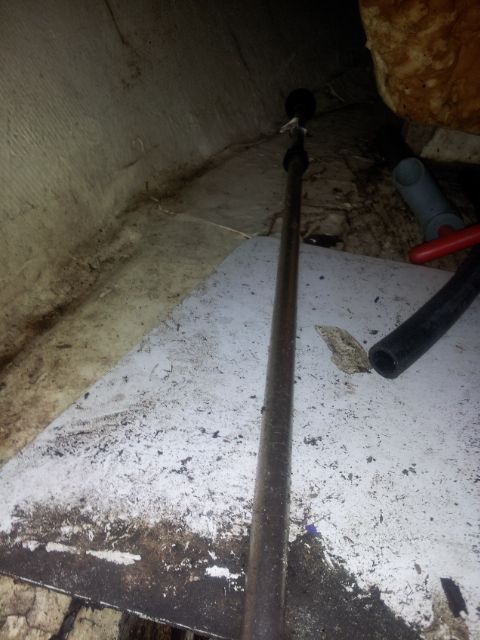

Cut the rear part of the deck off where the ski bracket was mounted, which was right above the center stringer.
That stringer is full of water. There is also a plywood core in the deck.
Photo under the casting deck showed it was full of foam, albet wet soggy nasty foam

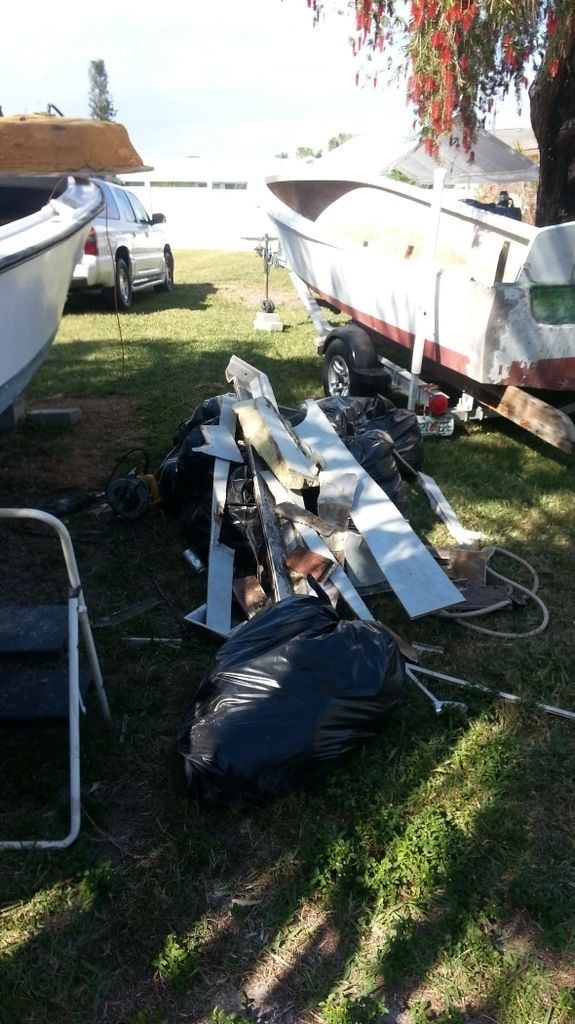

So off and out comes everything.

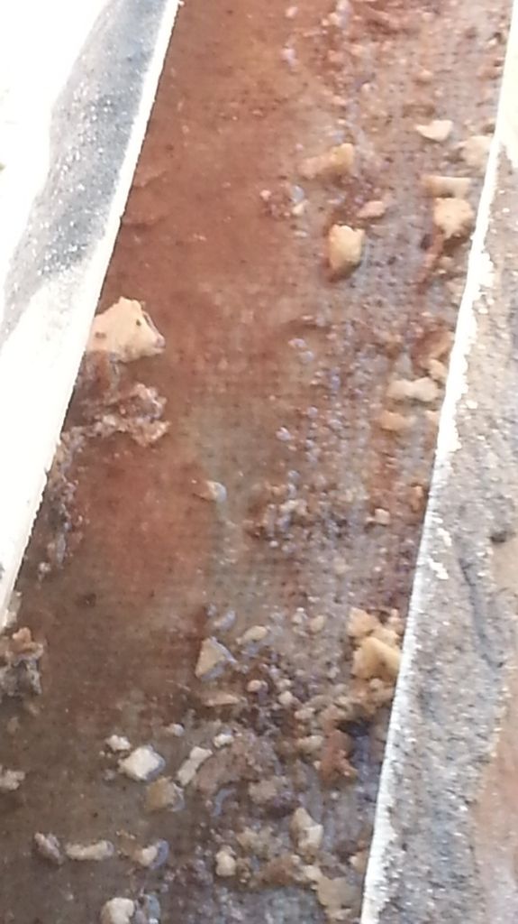

1/4" of standing water in a stringer, but more in others
Each stringer took 4-5 bags of wet nasty foam to the dump
