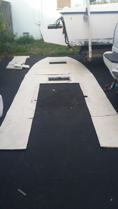

Yup shenanigans! picked up a 222 CCP today. Its in need of some work. Front deck is super soft. no console, no motor. The transom was enclosed and a bracket was put on. Its still not known how much work it will need, but con, emm i mean deconstruction, will start shortly. Even as a project boat this thing is pretty clean. we all know my pet peeve about dirty boats for sale.

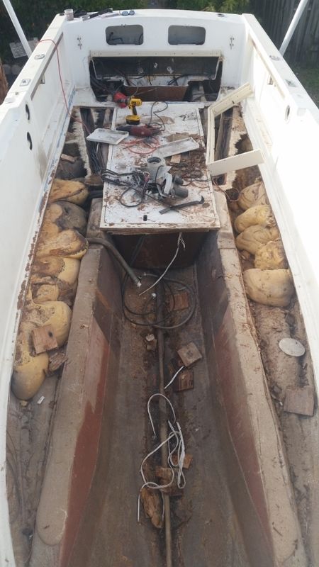

Wasting no time. the tank looks pretty good. i dont like the make shift bench over the splashwell. There is also some spongy spots aft. So the entire interior will come out. The backet will come off, clean up the corrosion.

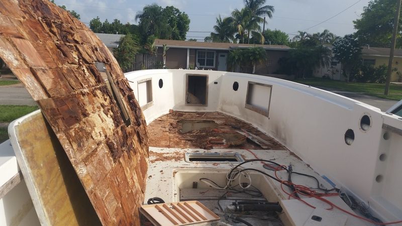

So far there has been 1 dry spot on this deck. so glad ive decided to rip it all out.

its getting there. foam in the back next to the srtingers is wet, which is to be expected. i drilled so exploratory holes in the stringers and they seem good and dry. i still have to figure out how to get the rest of the livewell out, bit its a start
