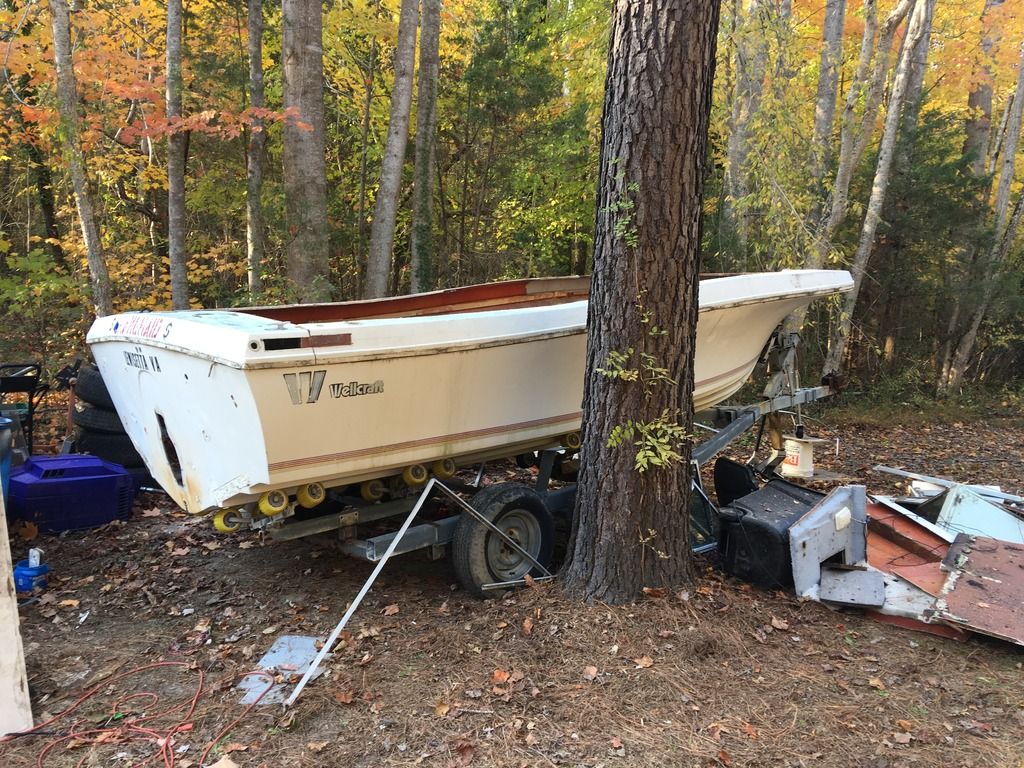

This may be the green machine replacement.
It's also a '79 but started life as a cuddy. I bought it for $500. Seemed like a solid foundation however rotten to the core. So my new plan is to build a completely composite "skiff" style center console. No fancy bells and whistles, just a clean, functional fishing coat. Going to close the transom in and put an OB on the back. I've already picked up a Stainless Marine flotation bracket for her. Got a power steering setup just got to get hoses made to length. I plan on filleting and gutting the stringers and using carbon core to fill them. As well as using it for the transom. Then using a composite board for the floor.
It's going to be a lot of work but I just love these hulls and they are just perfect for us here in the Chesapeake. Not too many 20' boats I'd trust to cross the bay but wouldn't hesistate in a V. Weather permitting anyways.

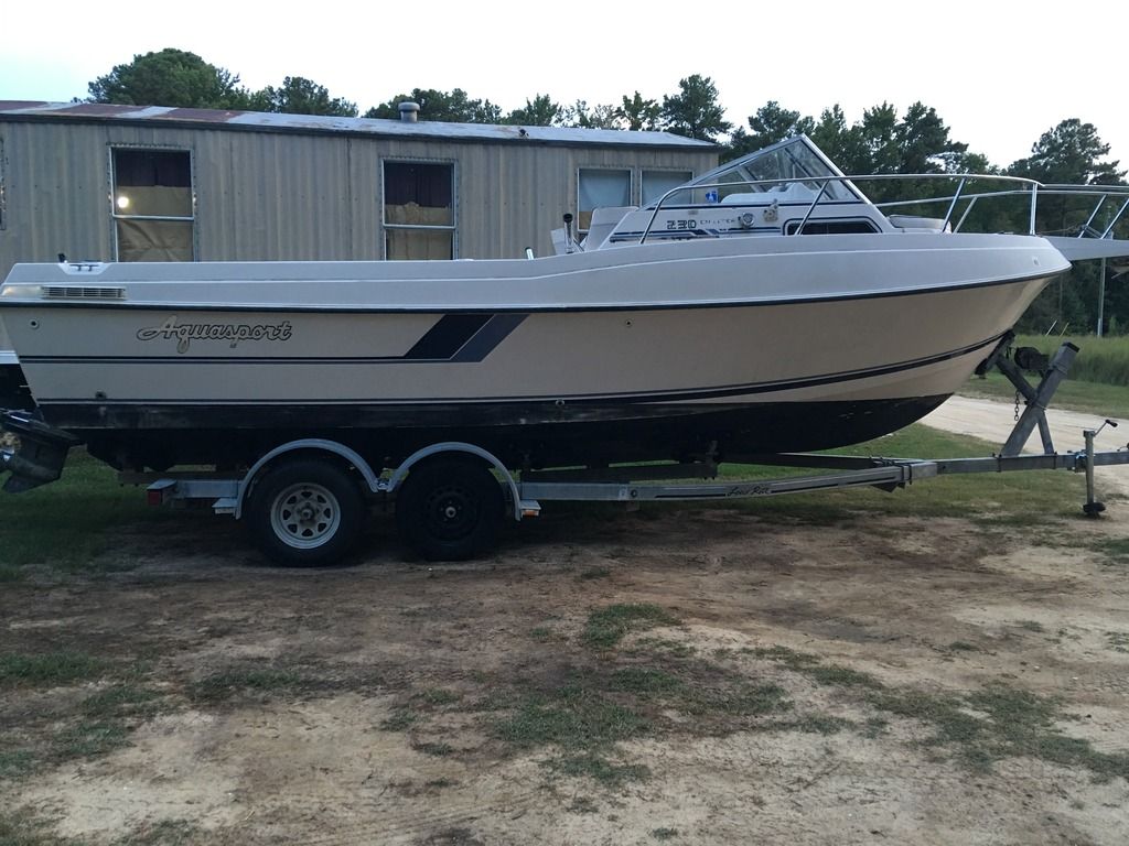

But then again there is this big guy...
Figured that'd catch you guys attention lil more than a V-20. Buddy of mine just acquired it in a trade and already tried to unload it on me. It's a 350 IB/OB and it appears the manifolds, risers and bellows need replaced. Says it runs well though. Haven't checked for solidness. I can probably get it for about $800 trailer and all. Been debating it I just really need another V in my life. Kinda addicted to them.
