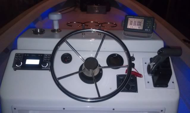

So the next great question would be where to mount this 741xs on my console? As you can see my console has a lot going on up top and some blank space down low. I would like to just top mount it centered where my 3-cup holder is on top, but then should I buy two 1-cup holders to mount on each side where my current GPS and external GPS antenna are mounted?
SeaBob sold me the current GPS unit about 4 years back when he took it off a boat during one of his rewiring jobs. Its worked well, but I have always wanted the added depth/fishfinder and a chartplotter with a more in depth map display.
The other option I thought about was mounting a Ram mount based where the external GPS antenna is mounted now, so I could turn the unit any direction I want while still using the cupholders that are already installed.
I don't think there are currently any flush-mount options for me, and I hope to add a VHF radio in the space below the Clarion head unit in the future.
And yes, my gasoline fill is right next to the external GPS antenna, and runs through my console. I have never loved that set-up and I considered moving it during my leaning post install, console shift forward, anchor locker install, and kiwigrip job last summer. I would have to cut into the deck and stringer to move it though.
So what do you guys vote? Top-mounted and centered where the cupholders are, mounted on a ram mount where the external GPS antenna sits now, mounted where the current GPS is, or flush-mounted somehow (I could move the radio)?

I like to stand when I drive so my first choice would be where the cup holders are but putting it where the old unit is would be my second choice
Posts: 1638
10,342.80 Points
Post Posted: Sun Aug 28, 2016 11:47 pm
Agree with Scott. You have limited space at present. Great new addition, so put it front and center where you can see it, the focal point for nav/depth, running etc.
Single cup holders can go to either side, and slightly in front of the new install...or elsewhere on the console, top later on.

could you also relocate the fuel fill to the side of the console. just along the same side of the console as it already is, just on the side instead of the top. that would clear up a lot of space for you.

All things being equal I would agree with Scott on the front and center location but I would ponder a couple items as considerations before deciding..
1) The Garmin unit you are installing is much larger than the one you have so would it could obscure your vision of the water when driving the boat. This was one of my leading factors to having mine off to the side on my boat. I do most of my driving from a sitting position and they could be in my way all the time so depending on how you drive I would check, I would hate to have to look around the unit all the time to see the water in front of your bow.
2) Do you do much driving in low light (early morning or at night). Even at the lowest setting with the unit in your line of sight to the water it will impact your night vision due to the size of the screen and proximity to where you will be looking. Again, line it up and see.. It does not take much light to impact or obscure your night-vision.
3) Replacing your existing unit with the new one will make a cleaner install.. The new Garmin bail mounts have wire tracks underneath them so you do not have to use a clam-shell to hide the holes for the wires assuming you can put the mount over the wire access holes.
4) I would wire your NMEA cable to the unit while you install it regardless of location so when you decide to do the NMEA network you don't have to mess with the Garmin mounting.
Finally, you will be able to get rid of the external GPS antenna.. The Garmin unit works great with the internal one. Keep the space on your helm for a VHF with is safety must have for the water and should be on your short list for upgrades as a cell phone is not a replacement.
Hope that helps..

Some good suggestions above the best being moving the fuel fill to another location on the console. Examining the photo of your console I'm going to suggest something that is going to complicate your dilemma. I don't see a compass and I highly recommend that you install one. IMO the compass is the single most important instrument on the boat.
Good call Fernando.. Remove the GPS antenna and install a compass (assuming there is no metal within the interference zone) Like the beercans in his tagline pic! sFi_wwe

Thanks for all of the input. I should probably mention that I have a leaning post behind the console now instead of my old cooler seat. So in that regard, I am usually leaning or standing while driving. No issues with seeing around a screen if it is centered. I'm still coming from the viewpoint of navigating around a lake in Tennessee, so I used to go out around sunrise and after dark all of the time. However, I don't see myself doing much of any navigating after dark on the Gulf. I don't believe blinding my night vision will be too critical for South Florida. I do like the idea of a compass installed on the console as well for safety. However, the OCD side of me would only want a compass centered on the console where the center cup holder is now. I could eliminate the cupholder, installed a compass centered in its place, then install the Garmin to the right side of the compass(it would occupy the space of the right side cupholder and my current GPS). I usually sit to the starboard side of the console anyway due to the throttle being on that side and if another person is sitting on the port side of the leaning post with me.
I could remove the external GPS antenna and try to move the gas fill to the side of the console (there is a stereo speaker on that side of the console as well). Would you guys just put a piece of starboard up there to cover those two holes?
I do want to get a VHF radio mounted below the radio very soon, as I agree with you in terms of a cell phone not being a safe means of rescue.
The eventual plan is to get either a T-top or a half-tower integrated into a T-top. So I don't know what antenna I could purchase and mount for the VHF until the time I get a T-top and mount it on top of the T-top. Is there an antenna that would be good for now and that could be mounted onto a T-top down the road?
