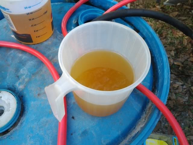

Sounds great JD! I remember the carbs were easy on mine... the darn fuel line manifold in between them was a pain with those six hoses. Here's a pic of my six carbs when I did them. Image
Oh and here is what my fuel looked like when I siphoned some out:
And this is what it looked like after being exposed to the air for a few minutes:
BTW we need more pics man!
