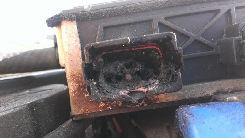

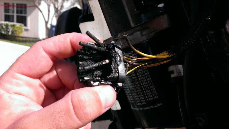

Post Posted: Wed Jun 08, 2016 4:31 pm
honestly i would get rid of the ficht. i had an 05 150 on my last boat. the motor ran great, ill give it that. but the ecu tried to smoke check its self one day. after that i just sold the whole boat. the newer styles 2000 and up have a lot of the problems figured out but they still are known to have issues with the ecus. heres what i ran into with mine, good thing i was at the dock
