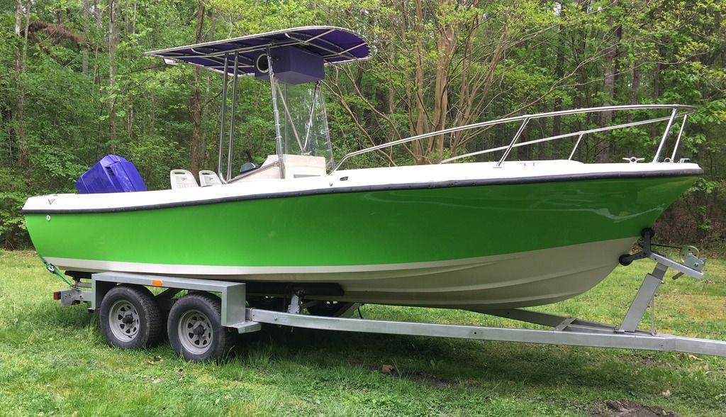

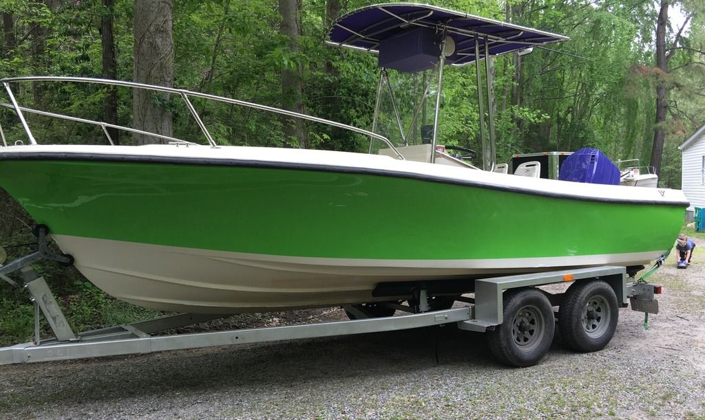

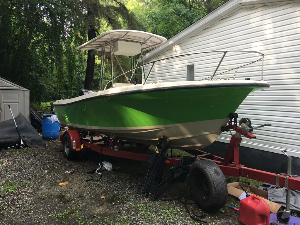

The pics he had didn't tell me much other than it was obvious the hull was painted a bright green and it appeared to have blue lettering on the sides. Well this is what she looked like the day I went and got her.
Wow...I know. It in fact was lime green but with many bright purple accents. When we pulled up to the marina they had it on the forklift bringing it out of the rack, my wife instantly shook her head and rolled up the tinted windows to hide her identity. Now I'm not one to bash on someone's style but yes, this thing was loud and it wasn't even running. It was definitely not my style but you know what the guy they call Taz, with his Joe Dirt mullet and bright purple T-shirt rocked the shizz out of his lime green and purple boat.
Once I got past the initial shock and looked past the lipstick I was pleasantly surprised at what I found. Seemed everything he told me about the boat was true. I went through it as good as I could and couldn't find any major issues. It was definitely worth the money I paid for it. Even with a blown up motor, $800 fuel tank and $1500 T-top I felt I couldn't go wrong.

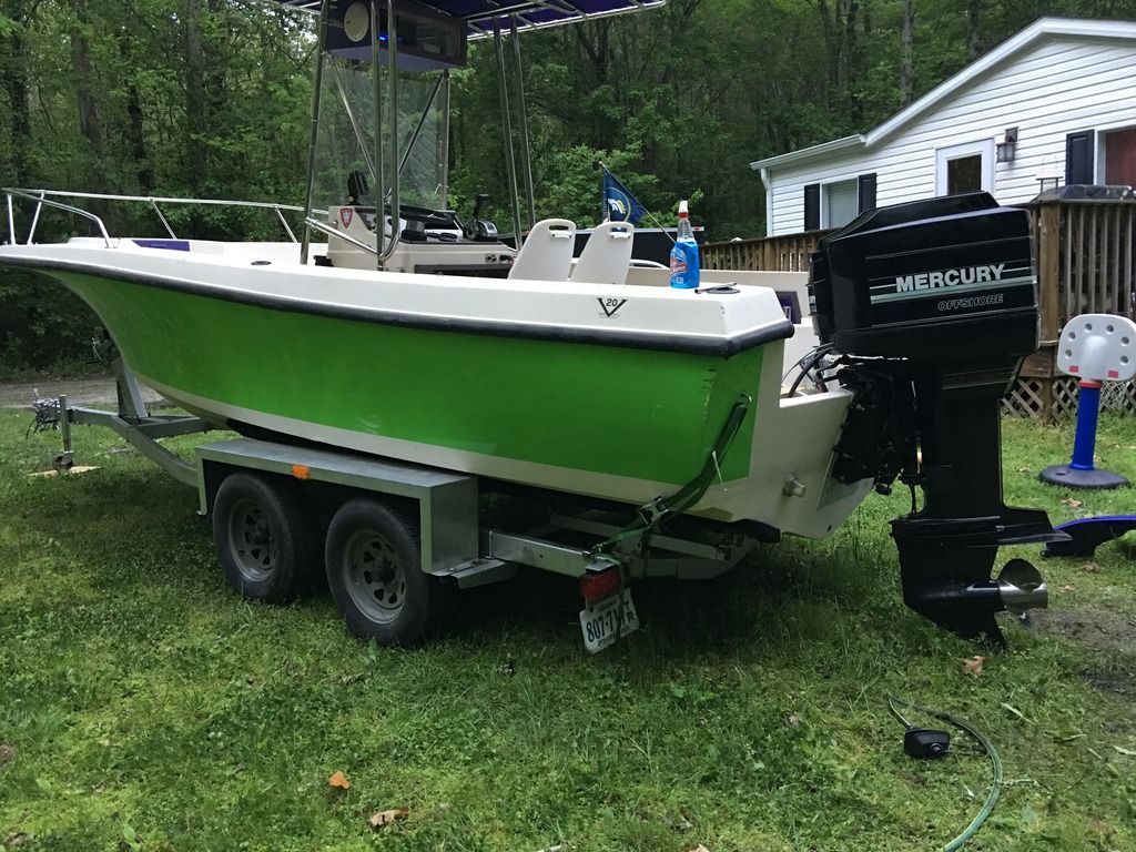

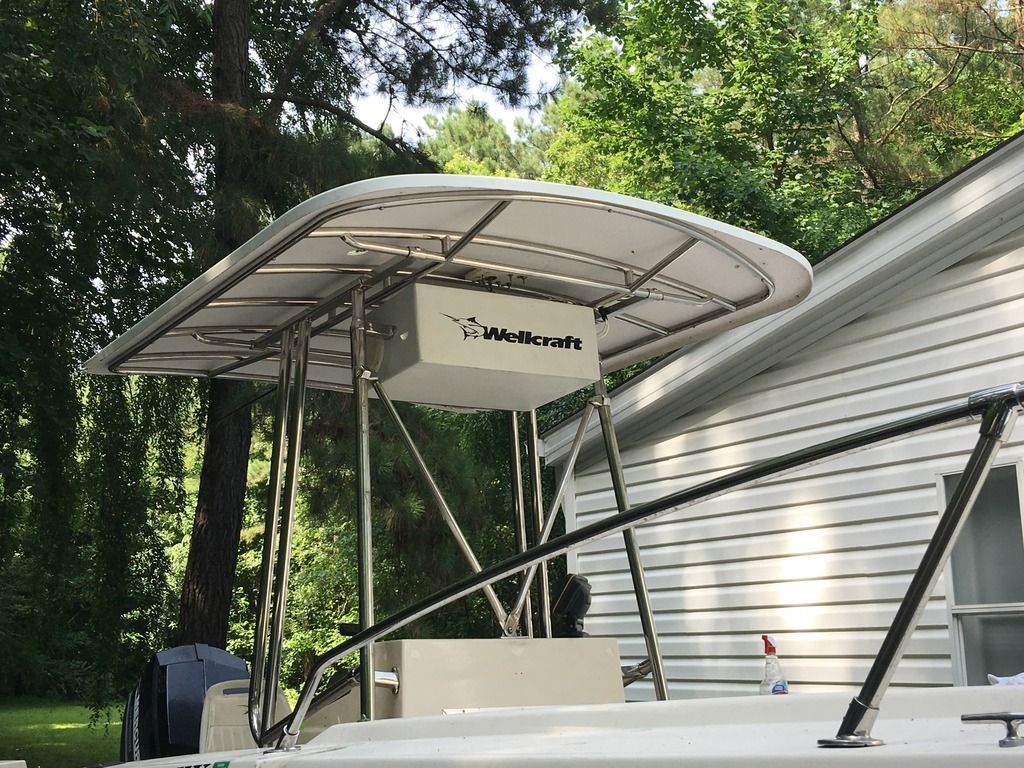

What a difference that made. Next thing I did which is temporary as I'm plan on getting a new E-Box was paint the E-Box white. Then I debated on getting a light gray or white canvas made but ended up getting a great deal on a cored hard top. Then slapped a little Wellcraft swag on the E-box
Luckily a buddy of mine had a spare motor cover laying around he let me borrow until I can get a fresh black coat on mine.
I borrowed the trailer to pick it up from my other boat (2150 Seaswirl Striper) so I needed to find a trailer quick to get them both back on trailers. Picked up a solid single axle trailer for $500 to just get my Striper back off stands.
I really don't like the way the boat loads on the trailer. I actually have a buddy with a tandem axle Calkins trailer he had for his V-20 which unfortunately got sunk at the dock after an abnormal low tide and the boat got hung under the dock. So he doesn't need the trailer any more and is gonna sell it to me for $200 but it needs some work but worth the money.

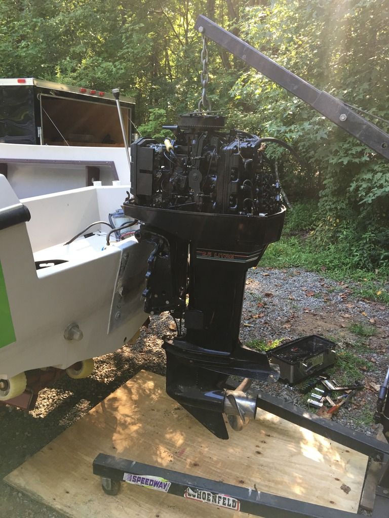

So I diagnosed the motor to find 1 cylinder with 90psi compared to the other 5's 125 psi. I bore scoped it and saw some minor scarring on the cylinder walls. My buddy who is a Merc fanatic came over and looked it over and we went ahead and fired her up. Instantly we noticed it was running terribly and also the water pump never started pissing. He got to looking more and found that the overheat alarm wire was disconnected. He had a suspicion this was why it was running bad. He plugged it in and we fired it up and it ran great.
It appeared the water pump went bad and the PO maybe unhooked the wire to get back to the dock without hearing the alarm however it seems that as a safety issue if you unhook the alarm it kills 3 cylinders. So then we figured the guy maybe didn't realize this and thought he blew her up.
After a water pump repair we made the decision to take her out and see what happens. My Merc guy told me he had motors in the past with the same issue(low comp on 1 cylinder) and ran them for years. So we launched her and she ran like a banshee. Hit about 49 mph and still had some throttle left (tach wasn't working)
Seemed all was going to be ok and I felt got the deal of the century, but my big head got deflated last weekend when the problem cylinder melted down. I now got 40 psi on that cylinder and the piston looks a bit messed up. Still not sure if I'm going to rebuild or repower. My local Merc dealer is about 800ft from my driveway so real tempting to get a new 150 4 stroke put on her.

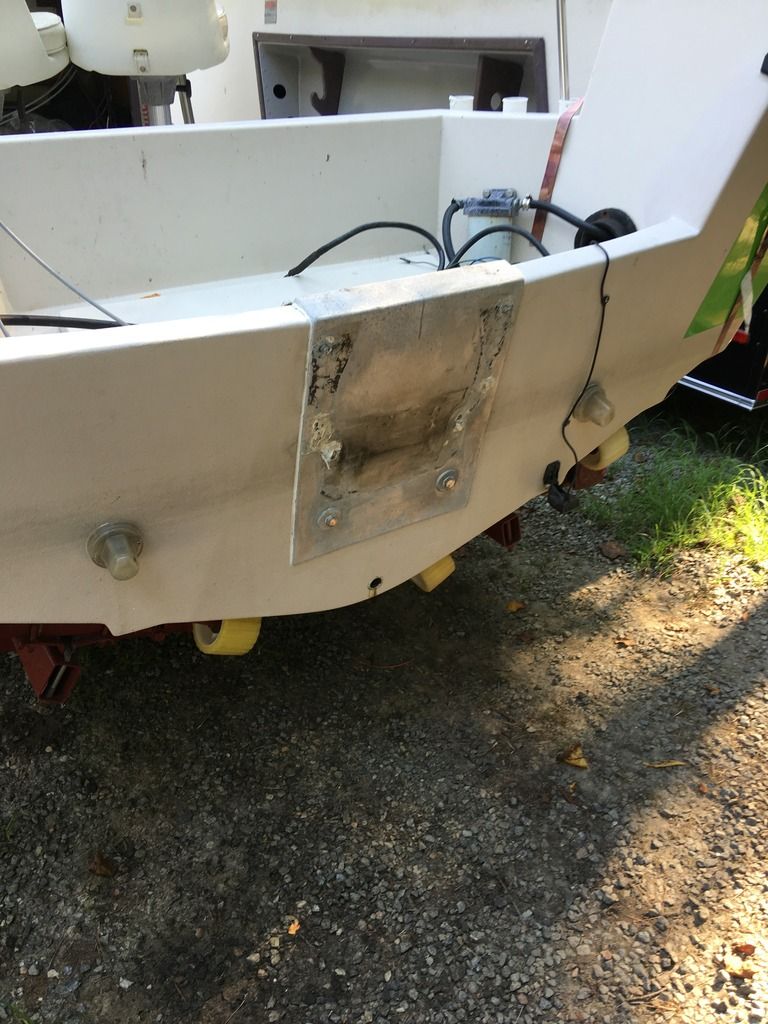

For now I have it back at my fiberglass guy getting some work done on the top and he noticed that around the lower motor bolts on the transom it sounds like there is moisture present. Seems those 2 bolt holes weren't sealed properly. He felt I could get a couple more years out of her if I sealed them up good but then noticed that the transom was raised to accommodate a 25" motor and wasn't done correctly so a full transom rebuild is in order. He's also repairing many small imperfections on the interior and going to reprint all that.
In the meantime I'm racking my brain with what to do about the motor. I have a very highly recommend tech that can rebuild the powerhead for me for around $1800 if the cylinder doesn't need sleeved. I'm really liking that price tag with the great reviews I've heard of about the guy. Also I must of dreamt about it or something but I woke up in the middle of the night with the idea of twin 90's. I know some guys here love their twins. But there's a slim chance that'll happen. I know it's not practical on a 20' boat but it does have some cool factor to it.

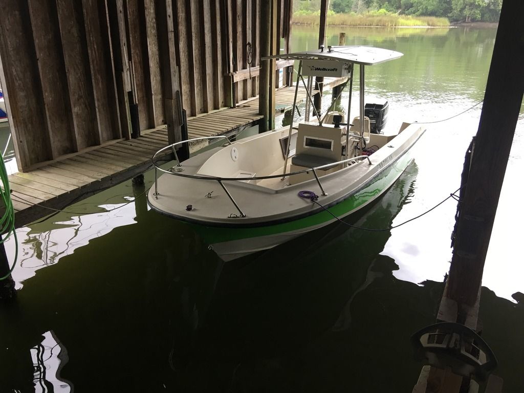

In the boathouse at my moms marina. Trying to talk them into putting a lift in this slip so I can leave it there and not have to paint the virgin bottom. Only response I've got is the suggestion I pay for the lift. It's tempting.

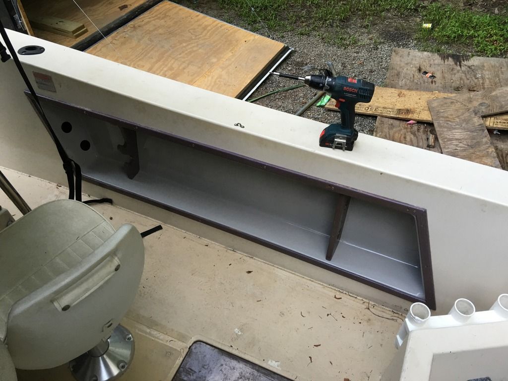

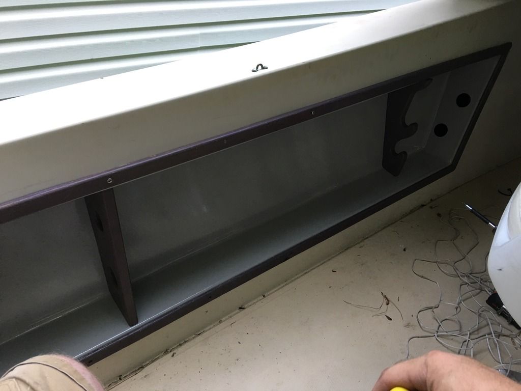

Gunnel boxes painted. Not as dark as it looks it was just real shady that day.

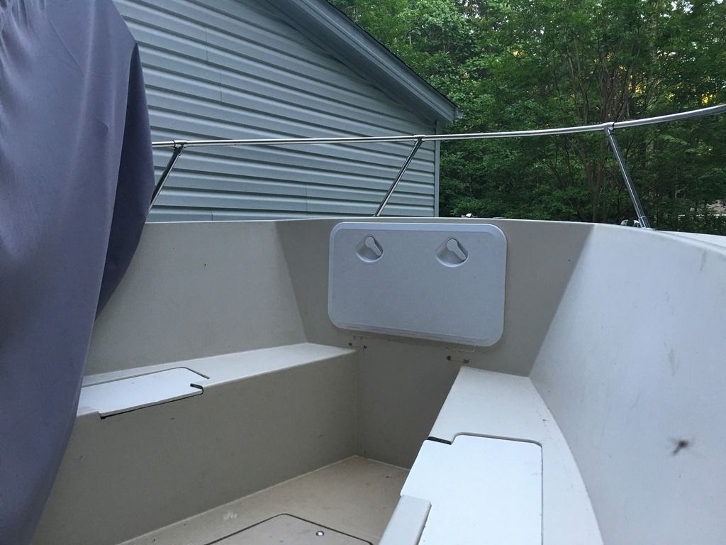

Ebay front hatch to replace the half rotted plywood purple door. This hatch was actually a bit wider to give me more room to access whatever finds its way in there.

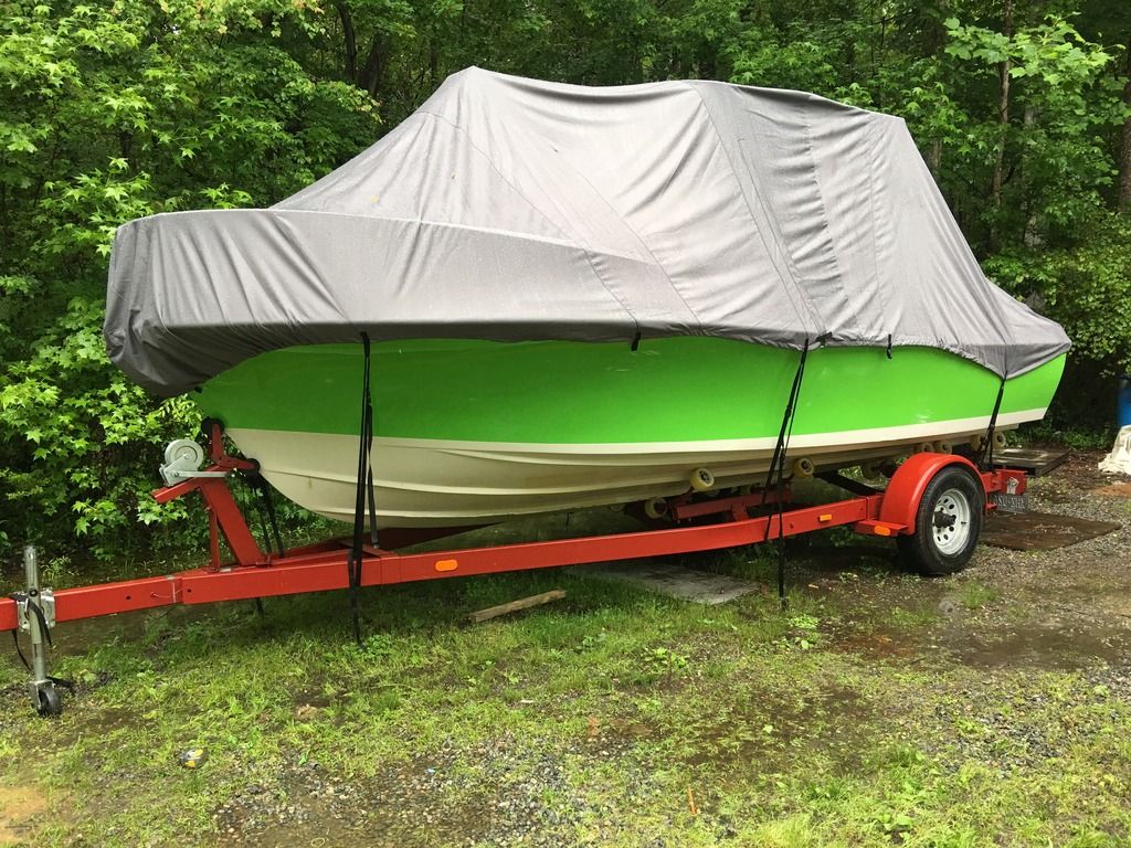

Spent a few hundred bucks on a nice cover. She's spent the last 15 years kept in a rack, last thing I want to do now is leave it outside in the weather constantly. Next on my list of home improvements is a nice tall carport to keep it in.

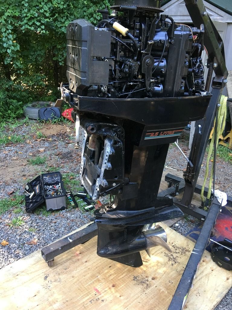

Finally got around to getting to work on the boat. Pulled the motor off today. Definitely moisture in the transom as I could dig wet wood out of the holes pretty easily. Took the boat back to the fiberglass guy and he's gonna start on the transom this week. I'll be taking the powerhead to the motor man this week. Hopefully I'll be back on the water in a couple weeks.
And we have detachment
Even under the aluminum plate the transom looks perfect, just seems the holes weren't sealed properly.
Motor just hanging out. Built me a $20 stand to put it on. All treated 2x8's. Solid as a rock but was too dark to get a pic. I'll grab one tomorrow.
