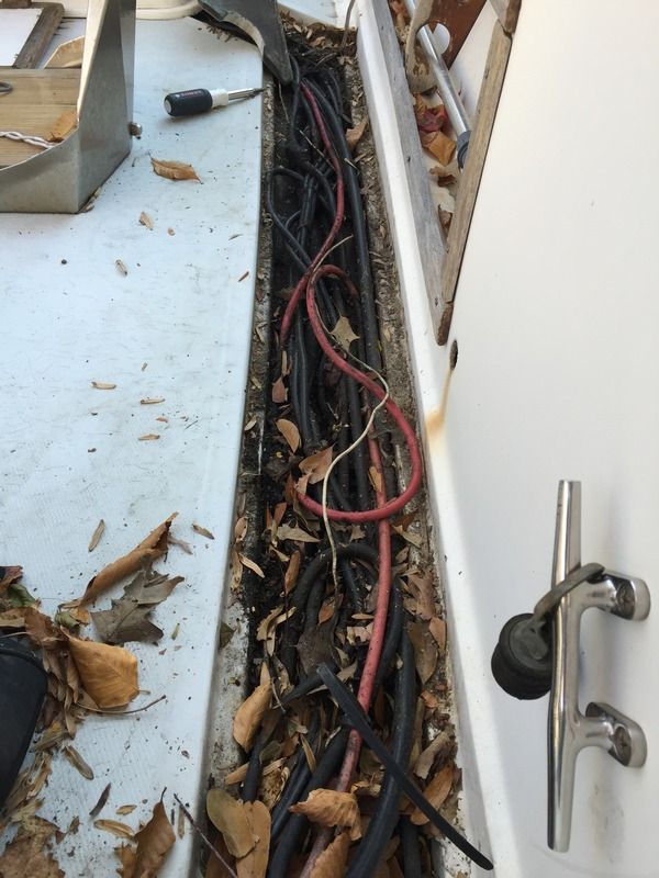

Well i picked this boat up a couple of weeks ago. And now that i am done with work and off till next March (2017) i would like to start to get her cleaned up and ready for next spring. She needs a lot of TLC!!! First step is to get her cleaned up a little and into my garage. I have order a replacement binnacle as this one was not in proper working condition. None of the courtesy lights worked, stereo is there but no good as well as speakers are toast. The gas tank will be coming out for inspection or replacement if needed. And a soft floor behind the helm seat. And a lots of other odd and ends that need attention
So my first few question are this. Anyone that may have this boat, could you tell me how the wiring for the bow navigation lights wiring is run? I notice that on this one the wire is just speaker wire running thru the starboard side where the rod holders are. Also what size screw are used to hold down the access panel for all the wiring running to the stern of the boat? This one doesn't have any screws holding it down and all screw holes were sealed off. Here are a few pics of what i found when i removed the access panel on the floor.

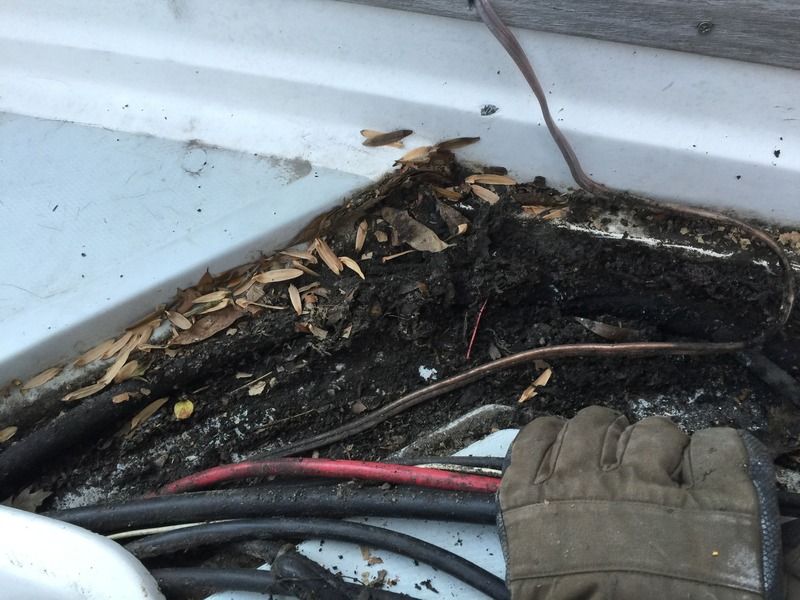

This is the speaker wire that i was reffering to that is powering my bow navigation lights. It runs thru the access panel in the floor and then comes out to the rod holders area in the gunnel. Where should the wire be going thru for the bow lights?

oh yeah thats a project for sure. dont rule out the possibility of having to rip the entire floor out. keep cutting out the floor until you get into good solid dry wood. look at my 222ccp thread in my signature. i went down 1/2" on the circular saw and pulled the top skin off. you should be able to get away with doing that, dig out the old core, put new core in bonding it to the old bottom skin and then bond the old top skin to that.
the screws are more than likely #10 or #12. the screws that hold your fuel tank hatch should be the same size
cant really help you on wiring though.

The wiring thing, all I can recommend is to follow the wire from the switch and see where it goes. You might have to cut a pie hole to work on the items, unless you just remove the bow light, and check for continuity back to the switch. Replace said bow light and call it a day. As for the fuel tank, if you have that issue with the cover, you are going to have issues in the tank area with corrosion. Since those are 30 gal tanks approx, not to much money to replace. Just make sure you get a front fill/vent and back draw so you get full usage of the tank. As for the soft deck, if it's small, injection is good for a short time fix (few years), if there are several spots, look at replacing the deck. Not to hard just time consuming.
